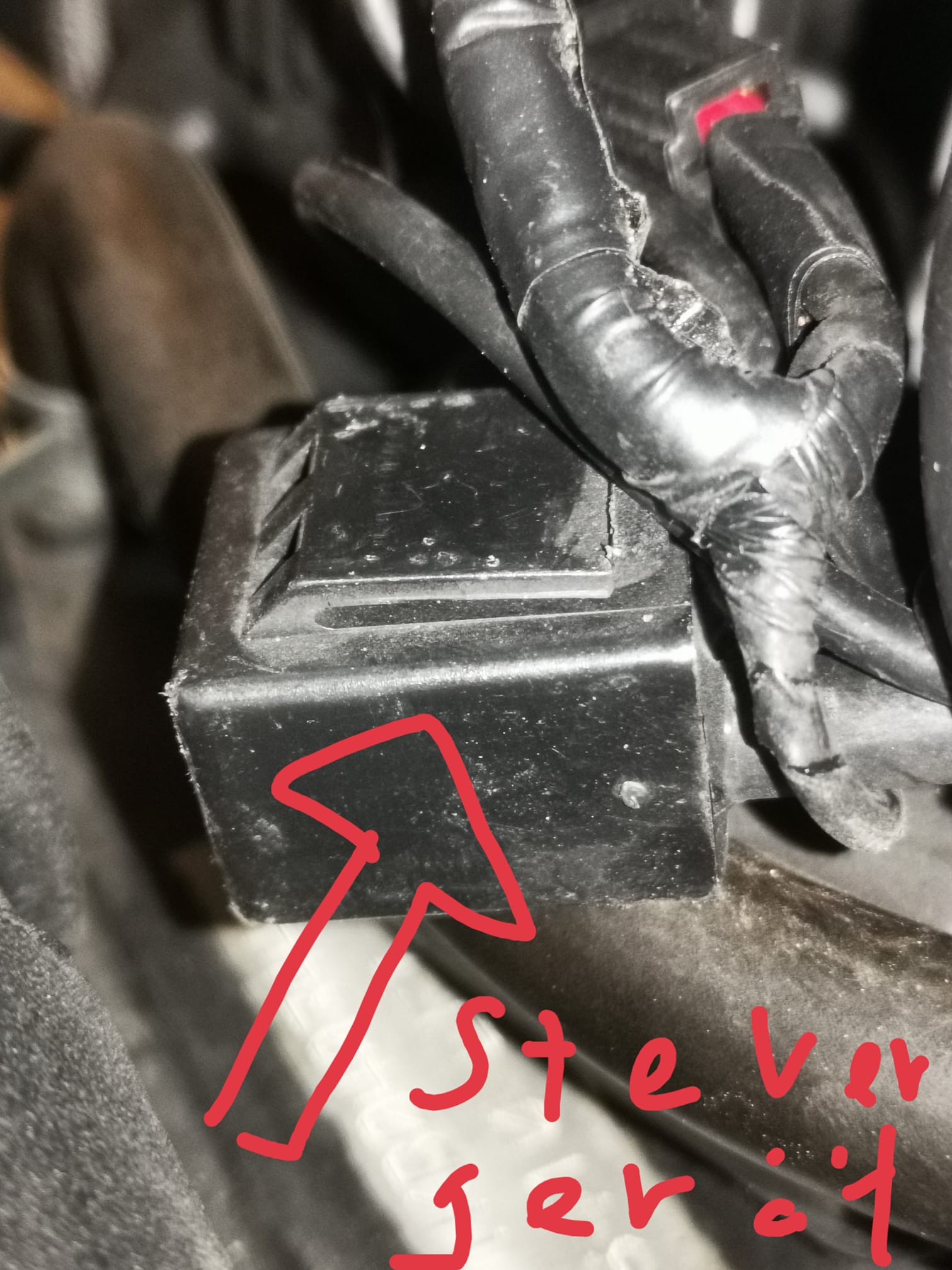

Under the seat / tank is the alternator regulator in an aluminum housing, with 3 connection groups.
3 yellow wires is the AC current from the alternator .
2 black to ground and to the negative wires. (Chassis as return line would lead to electrochemical corrosion on the steel frame because minus is ground).
2 red wires to F1.

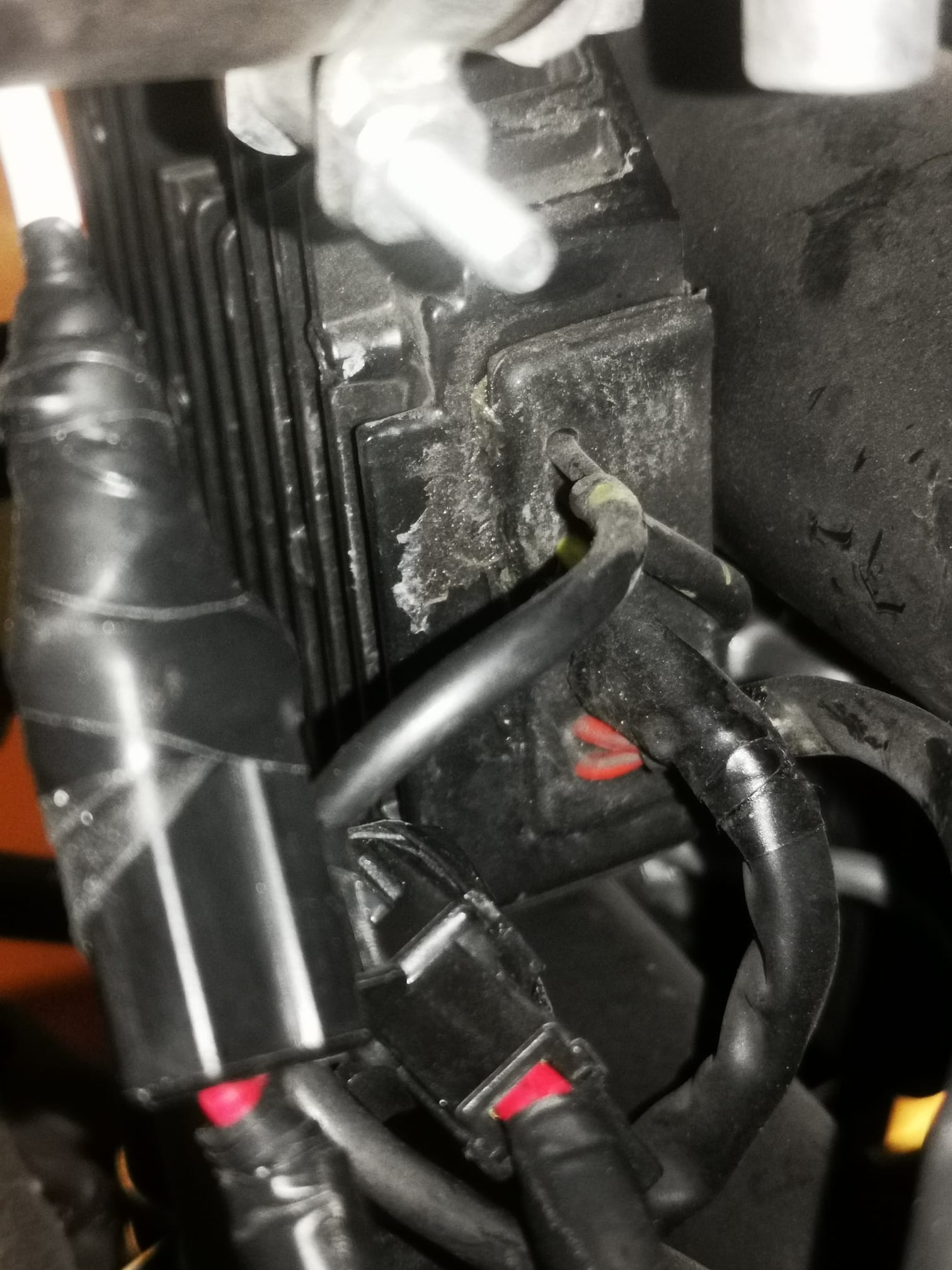

At the connector to the red wires is an adapter cable, which leads into a rubber bell, where the actual connector for the controller output cables is located. Pull it out on both sides, and plug the controller connector directly into the coupling in the rubber bell.
You could now nibble off the insulating tube layer from the short bridge cable, take out the naked cable leading to the controller, cut it off and solder on a longer cable. Connect this somewhere to PLUS after the main switch.
I have the horn (which is switched against minus) at the connection side behind the fuse tapped, and a cable led under the seat to control a relay, which switches the USB sockets and accessory connections. From this horn PLUS I then also fed the gear control circuit. I have left the intermediate cable in position, and connected to it by means of a 6.3mm flat connector the corresponding connection leading to the control unit.
