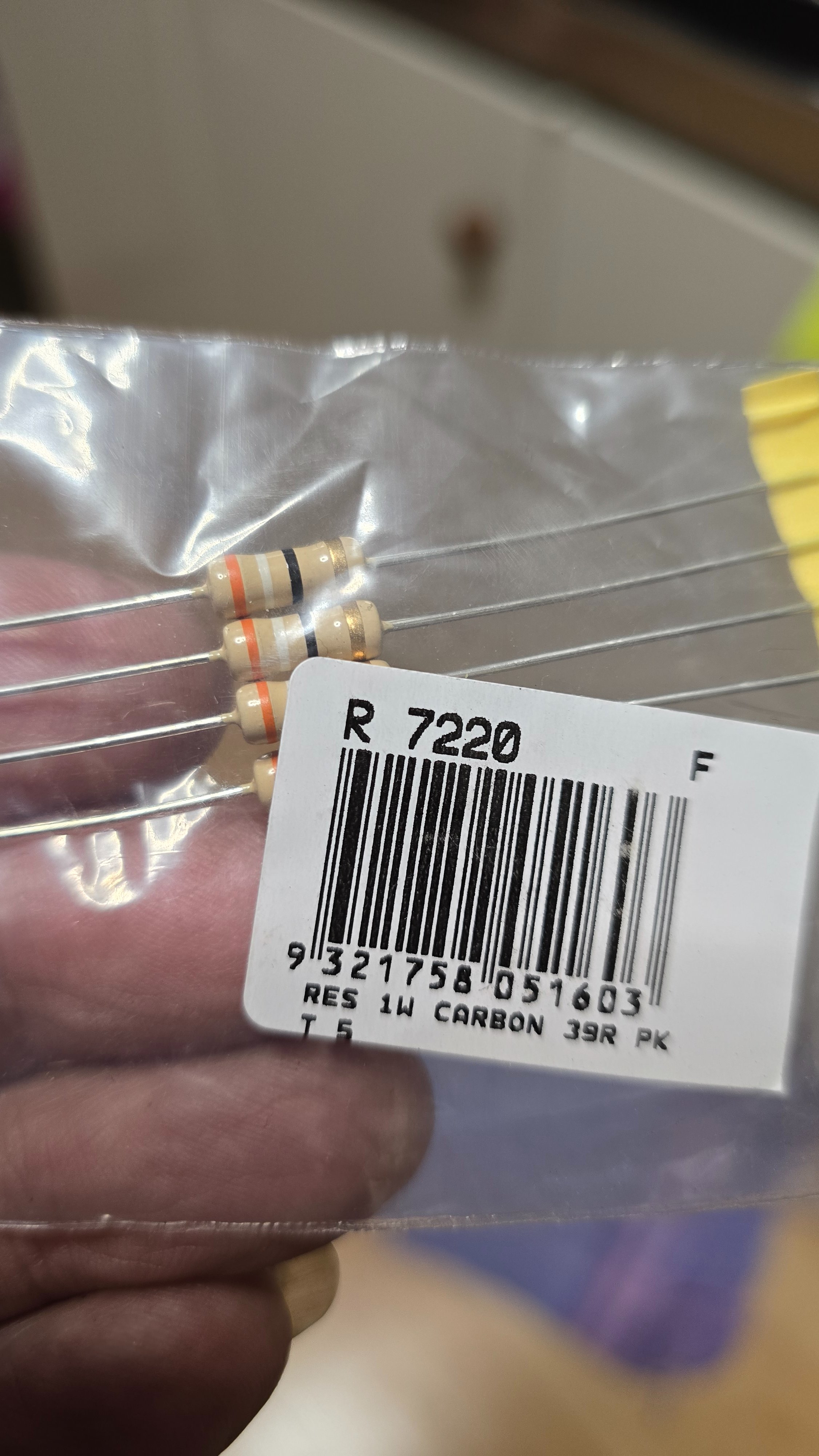

Then the little solenoid operated valve that purges the fumes to the Inlet, a small plug glued into the tube on the throttle body and a 39 ohm resistor was put in the electrical.plug so as not to throw a code.
These come in sets of 5 and cost less than 2 bucks.
If anyone wants one just PM me, it will cost you the postage.
