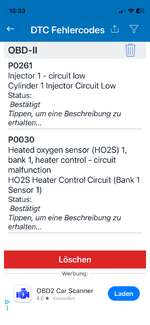

Good day to you all!
Since of today my Engine Light on my Himi 411/BS6/2022 came and stayed on - connected the OBD2 and the error codes read p0261 (Injector 1 - circuit low) and P0030 (heated oxygen sensor, Circuit Malfunction.
The bike has done 3000km, bought it with 1500km and has no engine or other performance mods yet.
I must admit, that I usually had older, carburator bike, so I am at a bit of a loss - can anyone help?
Also, living in rural Portugal does not offer any options workshop wise.
Thank you

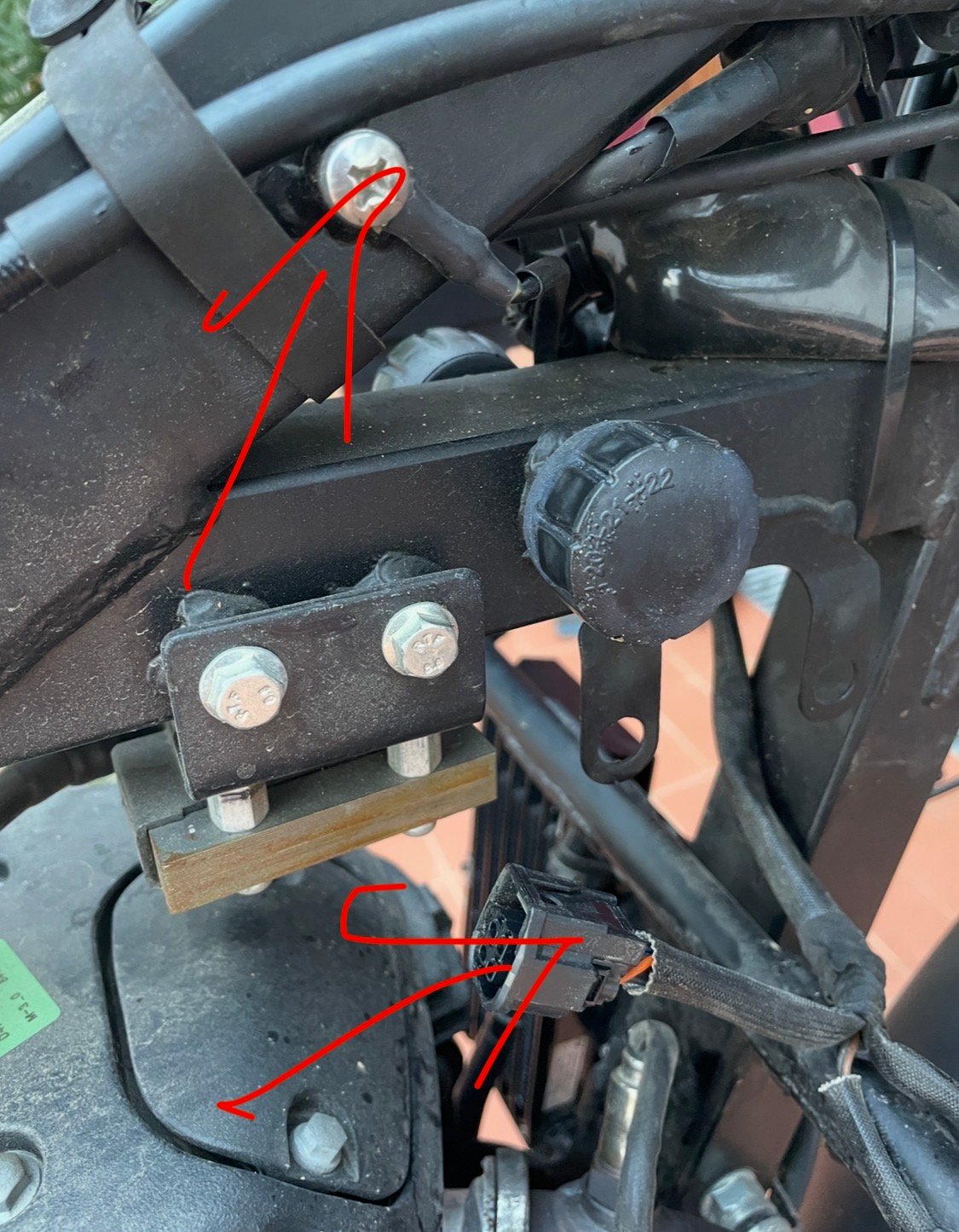

In the meantime I have taken out the sensor and cleaned it with a microfibre rag and a bit of breakcleaner.
I checked the wires of the sensor (seem ok) and checked the plug/connection - seemed ok but took it apart and put in connector spray.
Also checked the mass point on the upper frame above engine.
Bike has only done 3000km, basically new, but will check more for wires rubbing on frame etc.
I checked the fusebox under the seat - all good.
So, not sure how to continue - the sensor might be broken already, is there a way to check it?

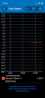

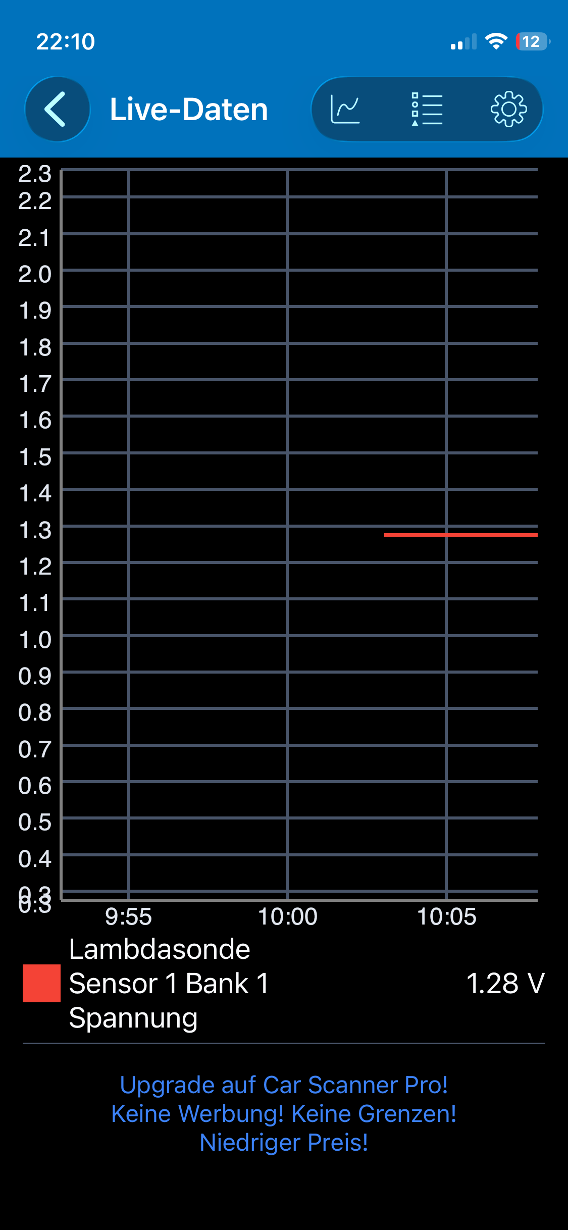

I have the feeling that the Heated oxygen sensor might be defect. As far as I could find in the net, the voltage should be oscilating between 0.1V-0.9V
My OBD says (if I am not mistaken), that mine is 1.28V and not oscilating at all .
Since I have not done this before (never had a bike with OBD, FI, Cat etc.), can any one confirm this maybe?
I measured with ignition on, engine off and using the Car Scanner App.

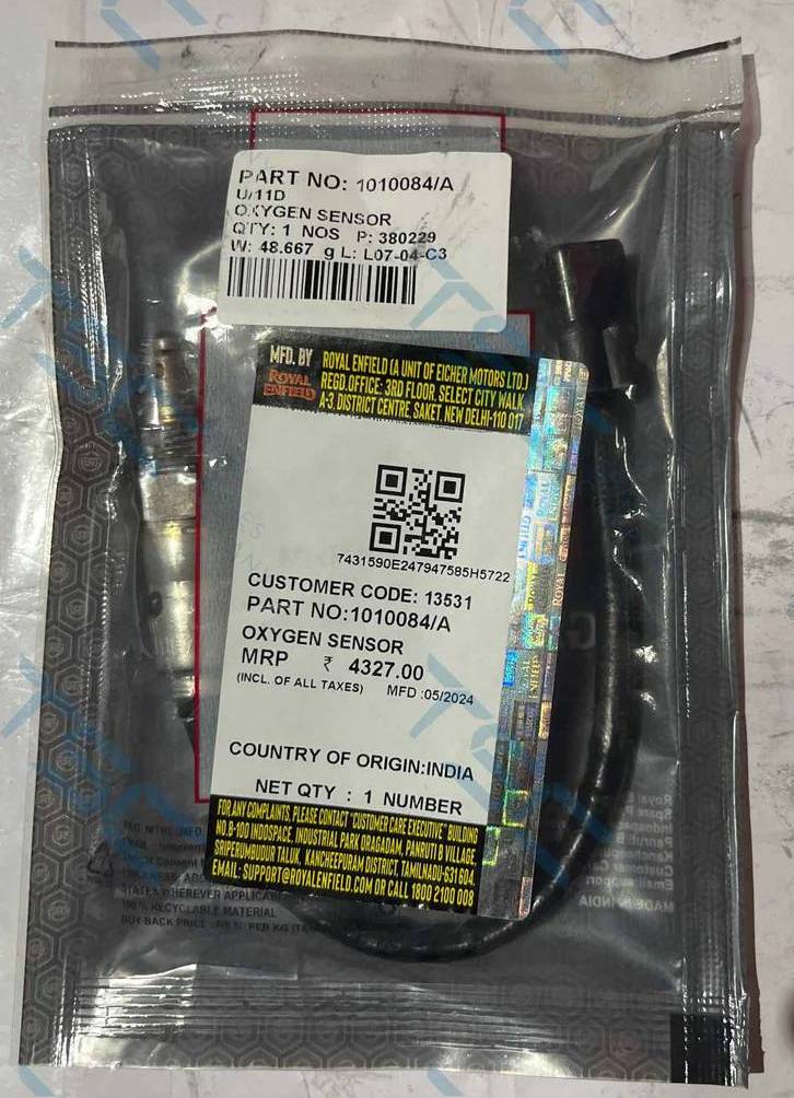

@Dool can you chime in here (he knows about O2 sensor and stuff)
the sensor is absolutely needed - in close loop mode the ecu reads it and manages the engine accordingly. AFAIK the Hima only has a simple narrow band sensor that can basically only switch between 2 values - too rich or too lean. They are inexpensive. Price here is 40 euros.

Yes, but in Portugal you can not buy it - in Germany/UK etc its more than 100€ (more like 150€ with postage etc.) and does not arrive over night. So I am trying to make sure I understand the problem first. Have not found that sensor on another bike or car either.

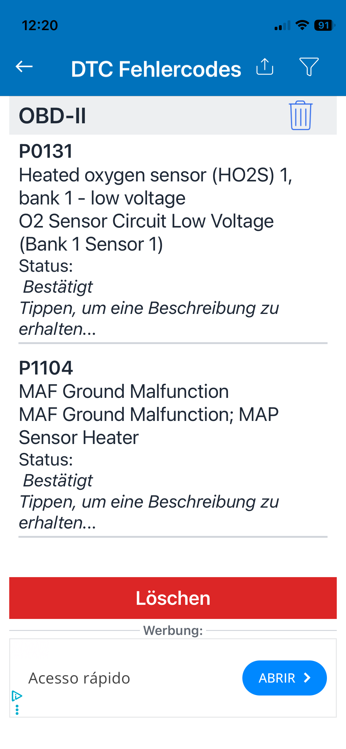

Thank you very much for your input, really appreciate it. I will elaborate a bit on what and how I tested, since my previous bikes never had FI, O2 sensors etc. and therefore I am at a bit of a loss. Also want to rule out my testing is wrong ;-)
1. Visual inspection
- was fine, light brown. Cleaned it anyway with a bit of break cleaner and a cloth
2. Resistance
- I saw that in a video last night and got a reading of 15 Ohm (Sensor removed from bike when measuring)

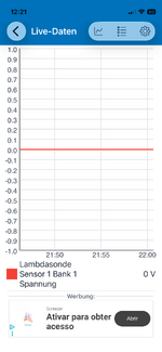

3. Testing the signal
- I removed the sensor, switched on ignition and got a reading of 12.5V at the Orange and the Blue/Grey wire. So the voltage gets to the connection at least.
- I dont understand how to ' Back-probe the signal wire (usually black) and the ground wire (usually grey), especially when bike is switched on?
- I did put the tank back on, reconnected all connectors (took them all apart to check for dirt or loose connections), run the bike and check with the OBD dongle and Car scanner app.

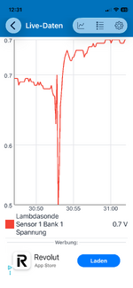

I connected the OBD and during start up there was a spike, but when the bike was running, it was a flat line at 0 (Photo)
When I restarted the bike the OBD wasshowing voltage, but nowhere near 0.1-0.9, more staying around 0.6V (Photo)
Also got a new P1104 Error, which seems related to Sensor heater (Photo)
Is it still necessary to do the above Back-probing ?
4. Lighter Test - will leave that to the last, would need to organize some clamps for my (very basic) Voltmeter.
5. Fake error - good point, have just checked it, all good
