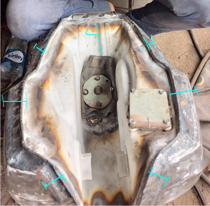

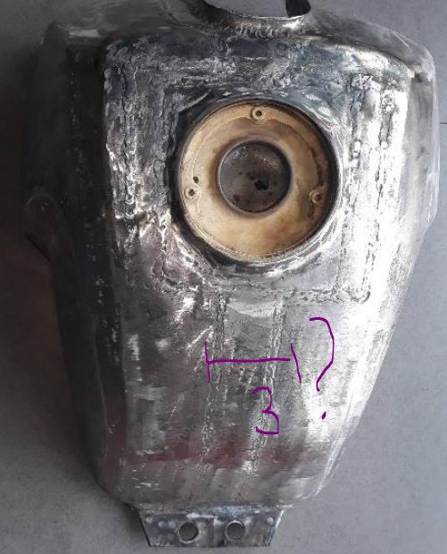

I will first determine wanted enlargement at the top, say 4 cm (image 1). Or, should determine the total enlargement from the welded strip on the second image? Then the third area to enlarge is the lower extensions which will have to be extended straight down and inwards (kinda 45 dregree) to meet up with the tank's bottom (image 5).
There will be 4 sections of the tank that will have to be welded to the extensions; these are 1. the fuel cap area, 2-3. the sides and 4. the bottom tank. Here is the part I do not have clear: the side panels of the tank are needed to be extended far down or just close the gap made by the overall fattening of the tank unit?

One more thing: although the tank was treated with the extra layer of welded on stuff it still developed a few tiny bubbles. These are very small and where not detected with the pressure test.
Did you see picture 2? Is that where you are supposed to estimate the whole number of cm and then welding the other steel strips accondingly to maintain the tanks shape?
the widening of 2.5cm refers to ONE SIDE - so a total of 5cm if you look at the middle piece.
you tank will be 20cm wider in total if you go ahead with 25 liter capacity
