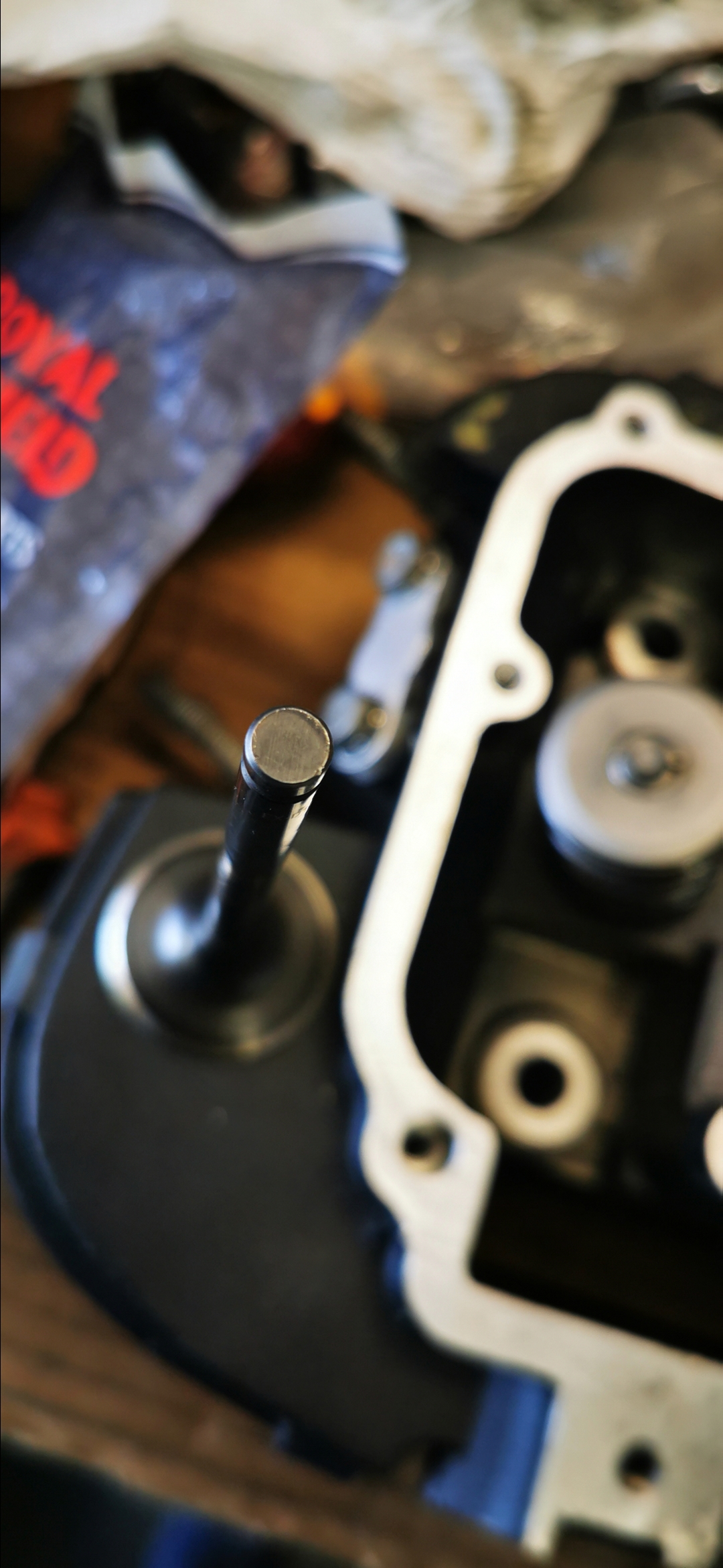

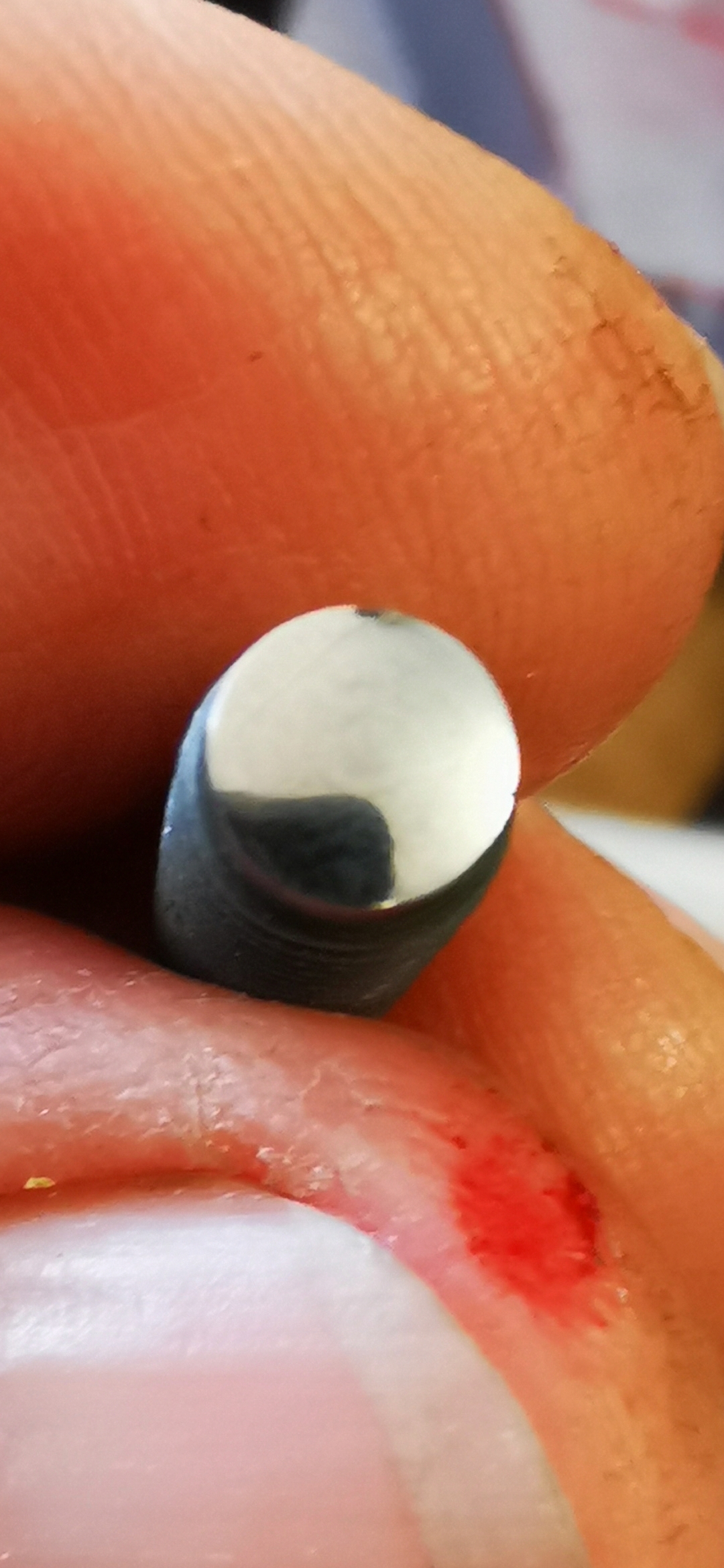

Are the R1150 good to fit then?I have just measured the RE tappet screw, they are a fine pitch 0.75mm thread M6 and 20mm long including the square end.
Not sure yet, after asking on a couple of BMW forums that I belong to, no one has got back to me regarding thread pitch. At the weekend I'll have a look at my R1100S, need to check valve clearance anyway. I just thought that the foot had a better contact patch rather than the domed Himalayan valve screw. There might not be enough clearance, wont know till I try.Are the R1150 good to fit then?
