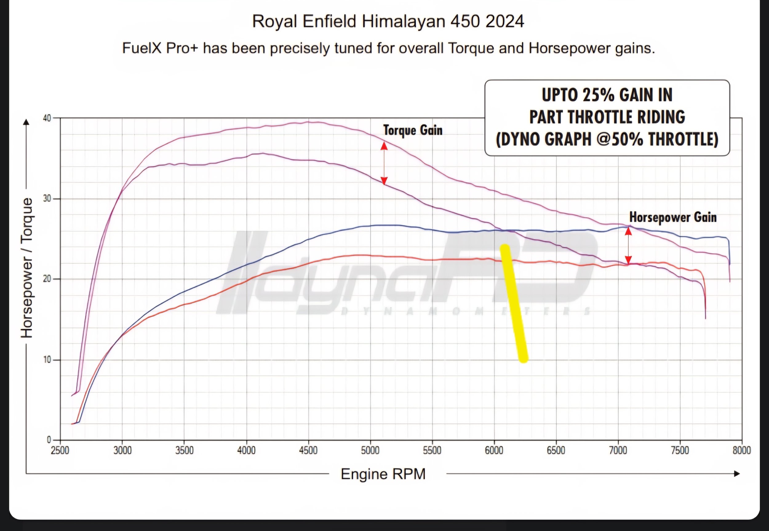

How does the ECU that expects a maximum of 2 discreet values from the o2 sensor in normal (no fuelx) operation all of a sudden discern 10 values from the same sensor (thru the fuelx pro cheat switch with 10 positions)?
and even if, how can that affect acceleration (open loop operations)? which is the moment you WANT more torque and power.
