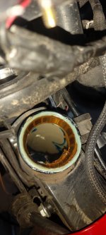

BS6: After 7000 km: bearings are shot, left shocker leaking (on top of the broken fuel pump)
my bs 6 suffered increasingly harder steering. the indian bearings needed replacing. i opted for japanese plus german marine grease for replacement. also left shocker leaked so new fork oil.

Rust Never Sleeps:cool:
The remaining Grease is an Odd colour! Looks more like Soap.
Lower is indicating lack of Grease as well as Water transgression.
Upper is good, but needs Grease :)
Almost makes me want to have a look at Mine:unsure:
