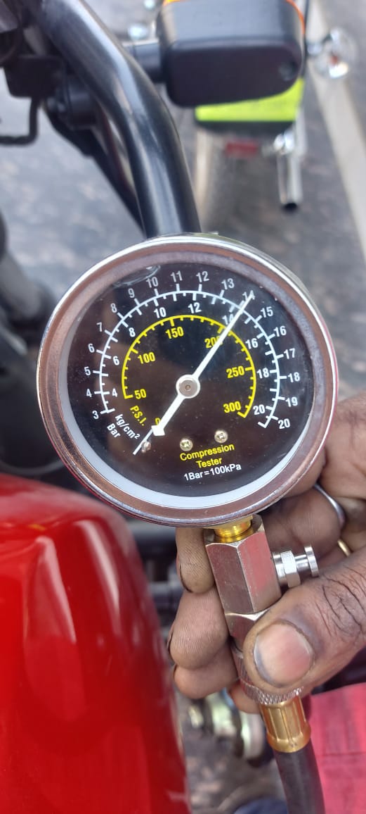

Have you tested the Compression ?
No but it was 190 psi last time and why would it change? But I can do it again one of these days. IMO the knocking comes from lean run, not from high compression. Also: I run 95 fuel only.
You have changed Cams? that can have an effect on compression, plus it is useful data when tuning.

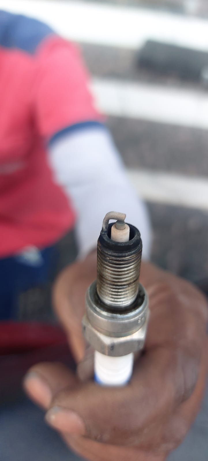

So here is the compression result from today. we used the grey foot gasket (our own product - more than double the thickness of the stock paper) and still got 207 PSI - about 7 more than stock usually gives. But that is nowhere near enough to explain the knocking which is quite frequent in spite of 95 octane fuel.
The spark plug, although not filleted as suggested by some, still shows clear signs of lean run.
Of the 2 maps available map1 is the richer one and it still leads to ample knocking so Racedynamics did a shit job with their dyno run OR the PT4 is a piece of garbage. time will tell. Maybe @Sasa can help with the timing (of which I am clueless). But I know that wrong timing can lead to knocking.

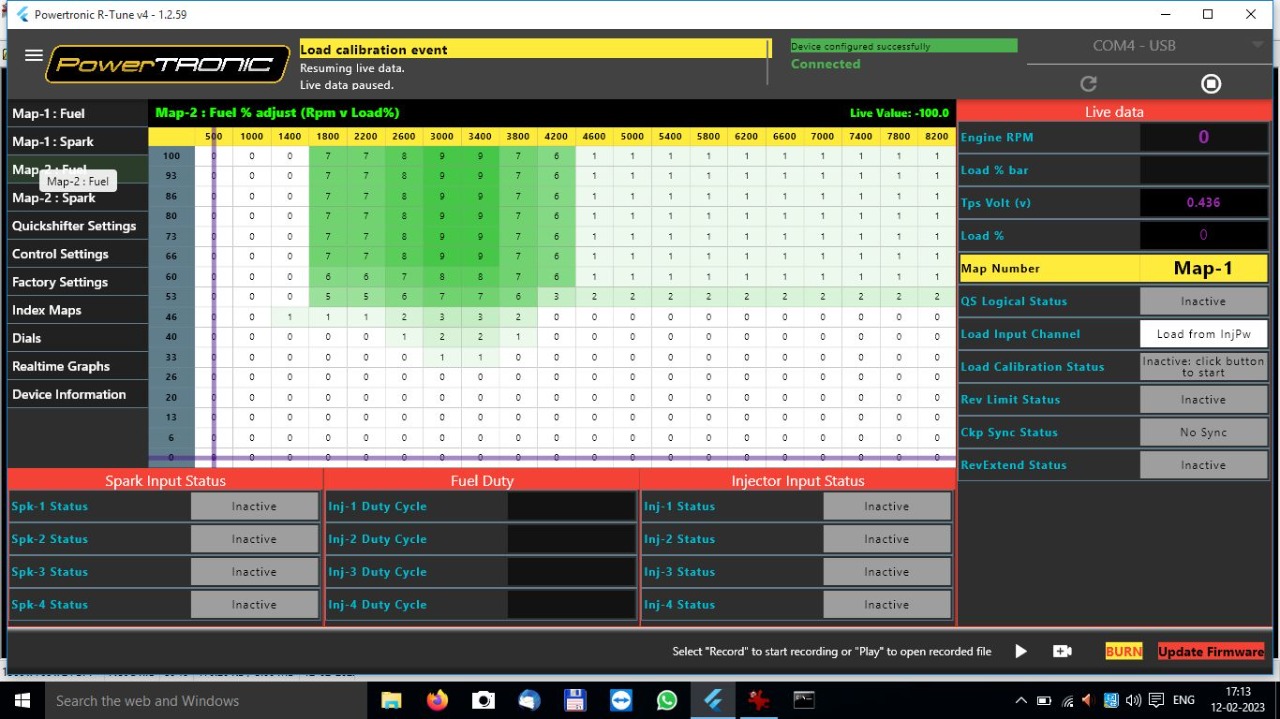

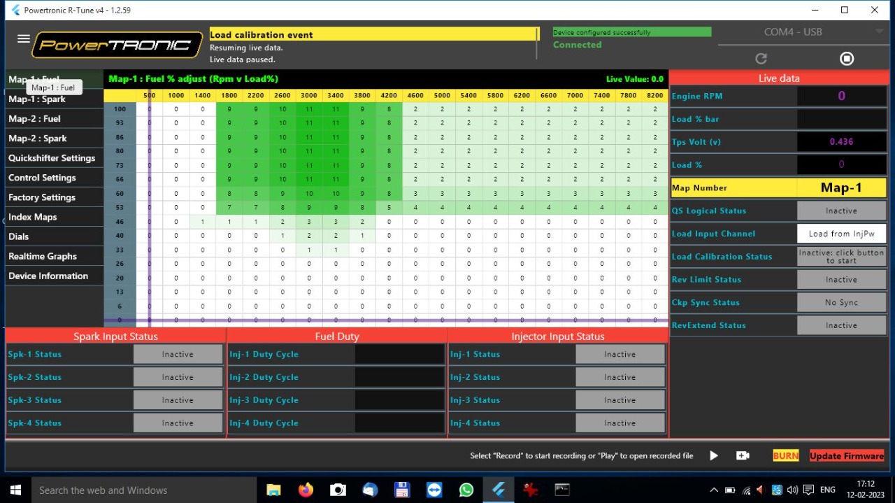

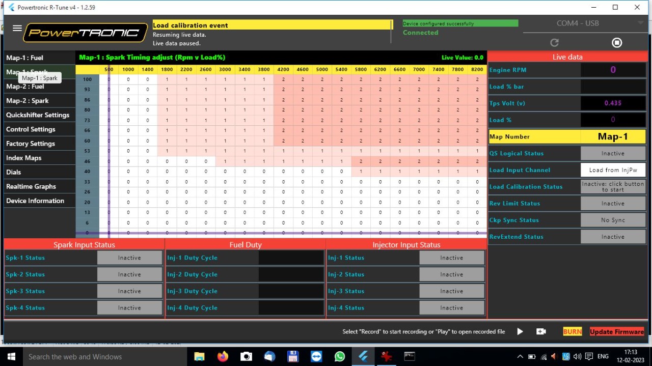

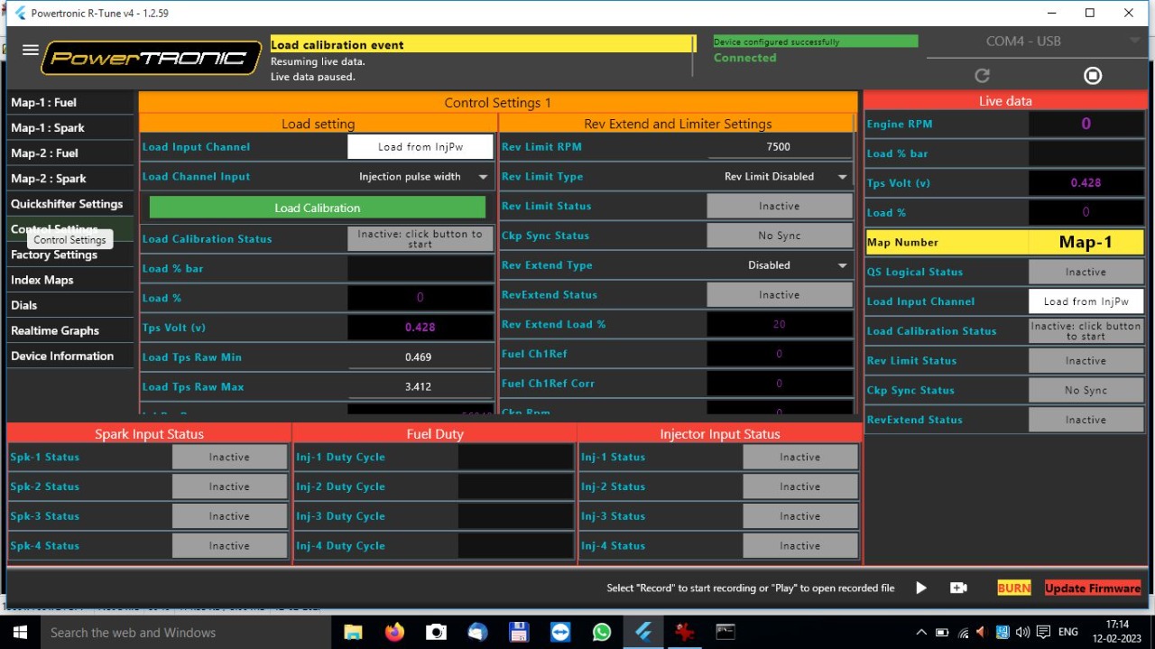

After I actually connected the PT4 to the bike and figured out where to click to have it "connect" to the notebook things went quite smoothly and intuitive. I did not need any help from the hotline (and sundays they dont work anyway).
I got the map ONX provided from the 477 they had dynoed by RD imported and activated, did the TPS calibration and the bike started right away (map1 - did not do much with map2 which is more lean and therefor less attractive) and idled at 1300 +- 50 - excatly by the book. There was a tiny hickup in the first 2 minutes when accelerating from low revs - it only appeared twice - then the bike ran very well - if it hadn't been for the frequent knocking whenever I did a bit of a sharp right hand move.
Power was not like the carby but better than stock - very similar to the "cam only with fuelx pro" that I had before (except that did not knock!).

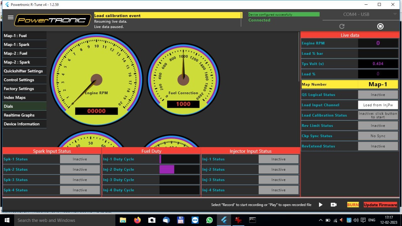

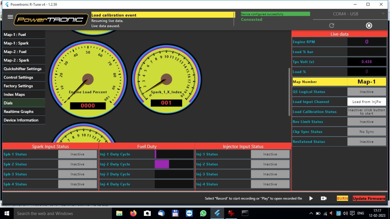

funny thing: in the DIALS department none of the dials would move when I reved the bike except -obviously- the tacho. So I am not sure I configured everything right and there definitely is space for improvement. I hope I get this straightened out with the help of the hotline and faster than it took to get the red box up to speed.
Here are some static pics from the various map configurations and the config page itself and the dials:

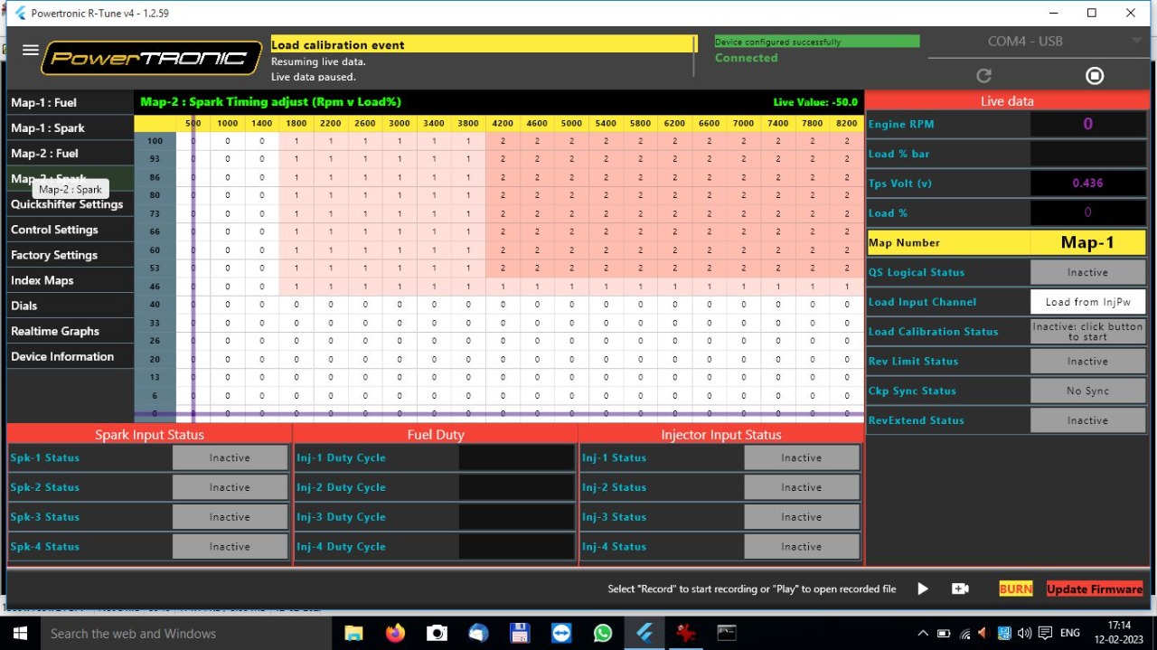

I'd say, by looking at it, that this map is garbage.
Sorry for being so direct.
There is 0% add on fuel (both map1 and map2) up to 33% engine load (0-25% engine load is where you spend most of the time...), so basically it is running like a stock bike, no wonder the spark plug looks lean and knocks...
I would add at least 3% fuel on every cell on top of map1.
Timing is very very conservative, if it's knocking it's because it's too lean, not too advanced...
Anyhow try to fetch the map I sent you a while ago when you had the V3. That was created basing on the values used by PC for the 462 of HMC. It should run well on your bike.
Use only one slot (map2) and copy each and every cell from that file, for both fuel and timing.
That should be a very good starting point.

I copied the cells from your V3 map1 onto my V4 map2 - it is not a 100% match because the RPM steps in V3 differ from those in V4 but I used the nearest value.
I did NOT copy the ignition settings (I would have if there was still knocking) - but a first test run on 15km showed zero knocking.
That is with only PT4 (no FuelX) and the values you gave me for V3.
It also seems there is more torque now (could be placebo though).

If you don't copy the ignition values, you're eating a half-baked cake.
Put the ignition values in and then compare the torque.
BTW your sensation is no placebo, there surely is more torque. Previously you were running basically a stock map at low RPM.
