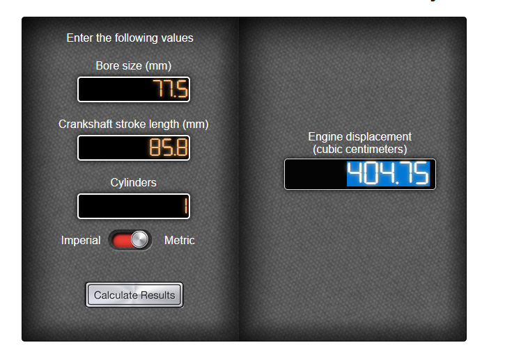

409.98 by my Calc, if it is a Himalayan piston.
OK, which one of my numbers is wrong?
I assumed it to be a Himalayan piston which in operation, normally would be in a 78mm bore.
Besides, the stroke is only 0.2mm ( 0.2 of 78!) less which is why it relates to only a couple of cc's less than a Himalayan. :geek:
OK, I used my digital caliper to measure the piston. might have created that error. 410 then. but I already did the labels ...
