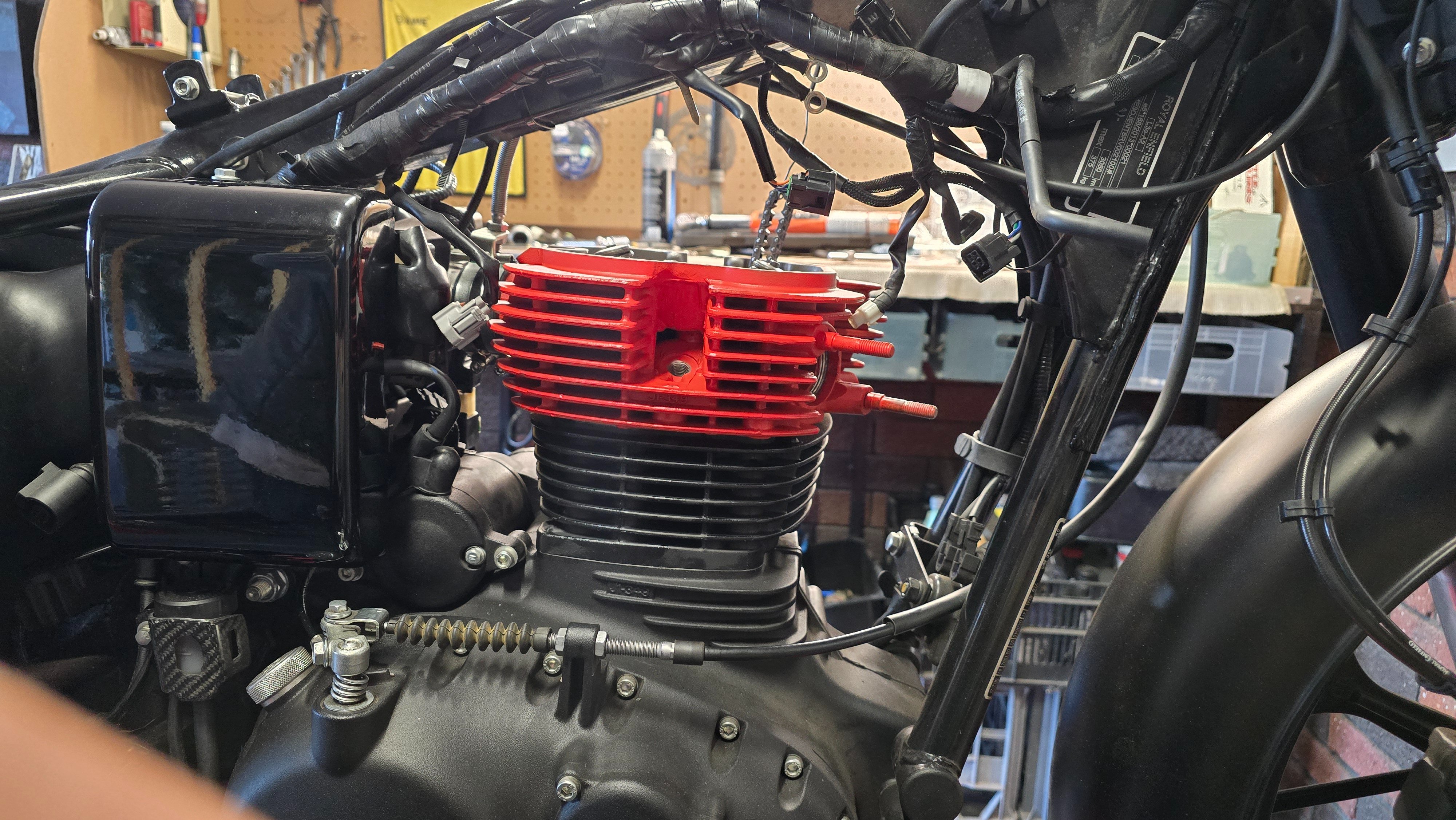

Head is resized, Ports have been cleaned up and matched to the seats.
Combustion chamber is raised and Valves de shrouded, 2 base gaskets so a bit extra capacity.
Next week I will try to get it up Mt Greenmount in top gear holding the speed limit, couldn't do it last time I tried.
This is how it is fitted for 411, I intend on just making it bigger when I fit the next larger Piston.

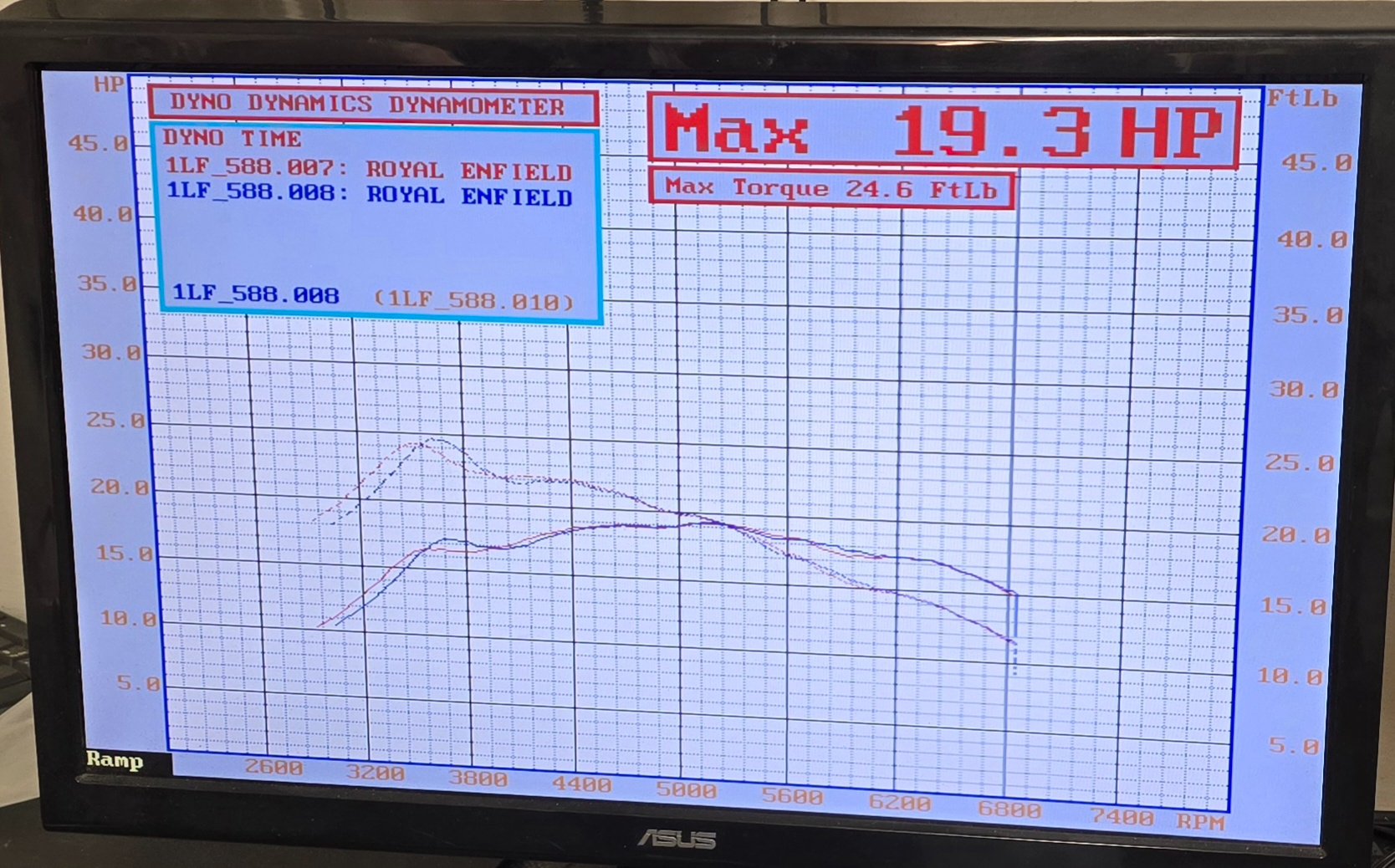

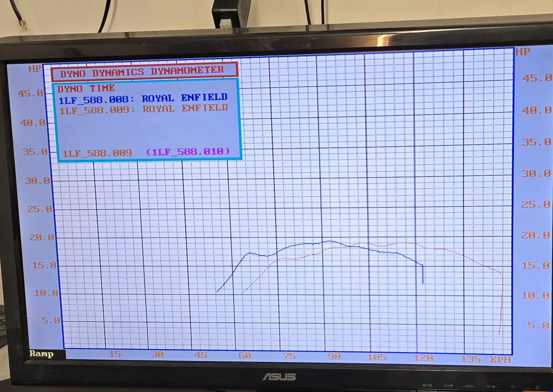

Updating, the 411 kit and Cam plus Fx pro performs well, it goes up Greenmount hill in top gear and has plenty of power.
Had it almost Dynoed but the Computer connected to the Dyno failed to boot up.
Now after sitting on my Butt for 6 weeks in Thailand I am back home so today I decided to get it ready to Dyno.
I decided I am not using the "special tools" that RE recommends, for a couple of reasons.
Firstly the Cam Holding tool is a piece of crap and is not as accurate as it is supposed because the locating pin is tapered where it contacts the Cam and is loose in the hole of tool as well.
I will post up a Video to show what I mean shortly.
And the TDC tool requires the clutch cover to be removed so as to set TDC accurately whist the Cam Tool lets its down by not being accurate, so why drop the oil, change a Gasket and perhaps have trouble setting the Clutch throw out.
I also decided not use the HMC Cam nor my modded head, so this build will be ,411 kit, decat pipe and airfilter cover removed only.
Stock muffler as is done on Hitchcock's J series Dyno ( stock vs stock plus Cam )
This should give a good indication of what the capacity increase gives in extra power and also will be the Cheapest option for any J series Owner.
Before strip down I did a compression test seeing 165psi, that would be due to the material removed from the combustion chamber and the 2 base gaskets I used.
So now it is 2 base gaskets and stock head and Cam I am expecting 190psi or more.

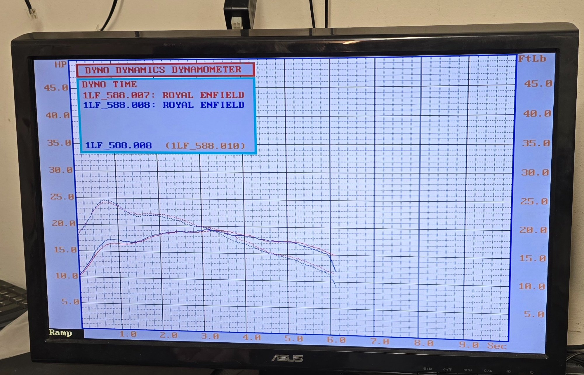

Then off to the Dyno.
No Greenmount hill test but a 100km run mostly at 100kph today.
Fx set at 3, ie turned off according to Race Dynamics plurb.
AFR Meter which is not calibrated shows 14's and low 13's, bike runs well and showed no signs of over heating, no clicking sounds after shut-down and no smell.
As for how much better it is opposed to stock is yet to be determined as the Dyno is not available at present, working on that!

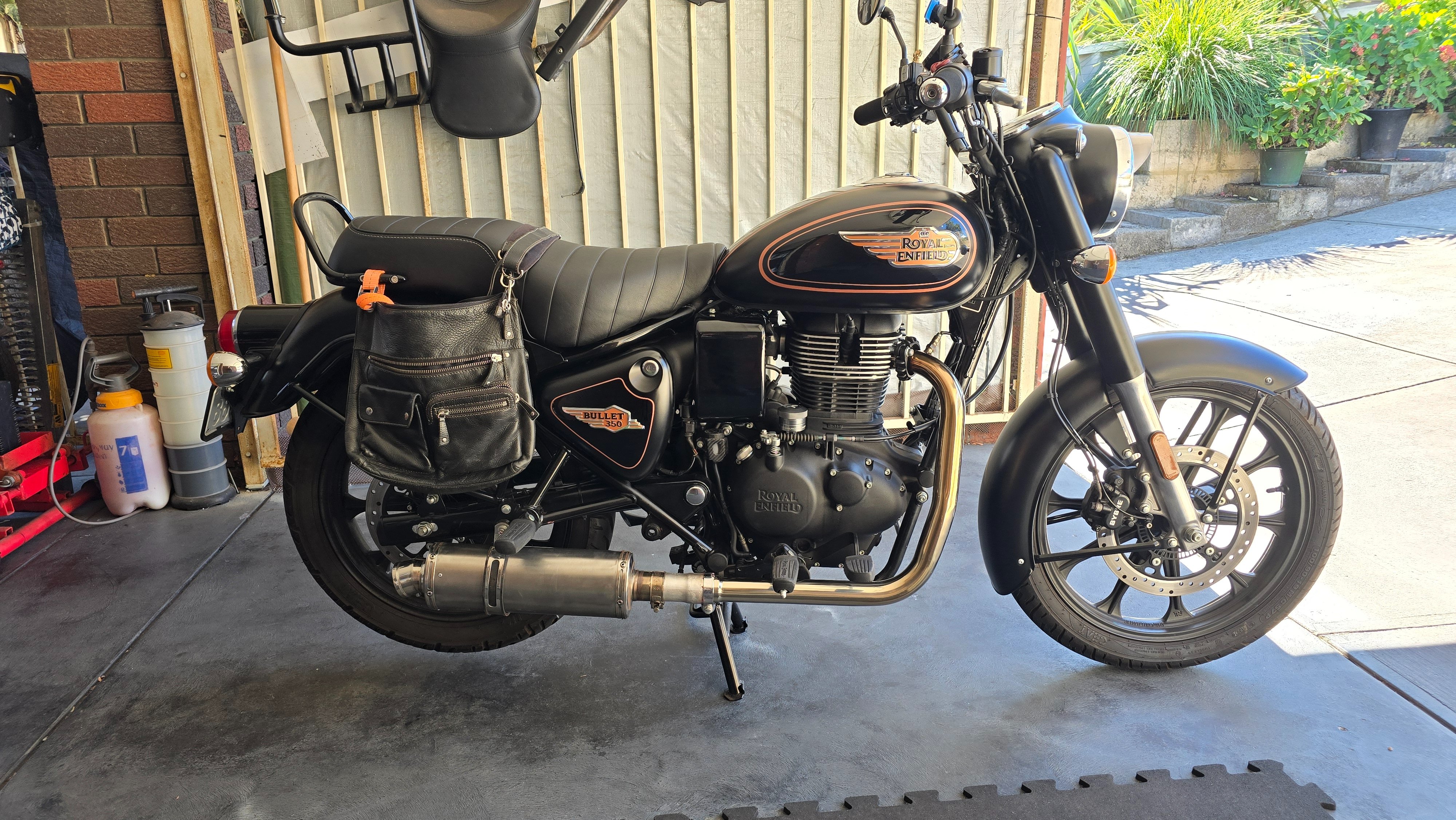

So far I am impressed with this simple improvement in its simplicity and cost ratio, okay it involves removing the Head unlike a Cam swap but it is not a hard job.

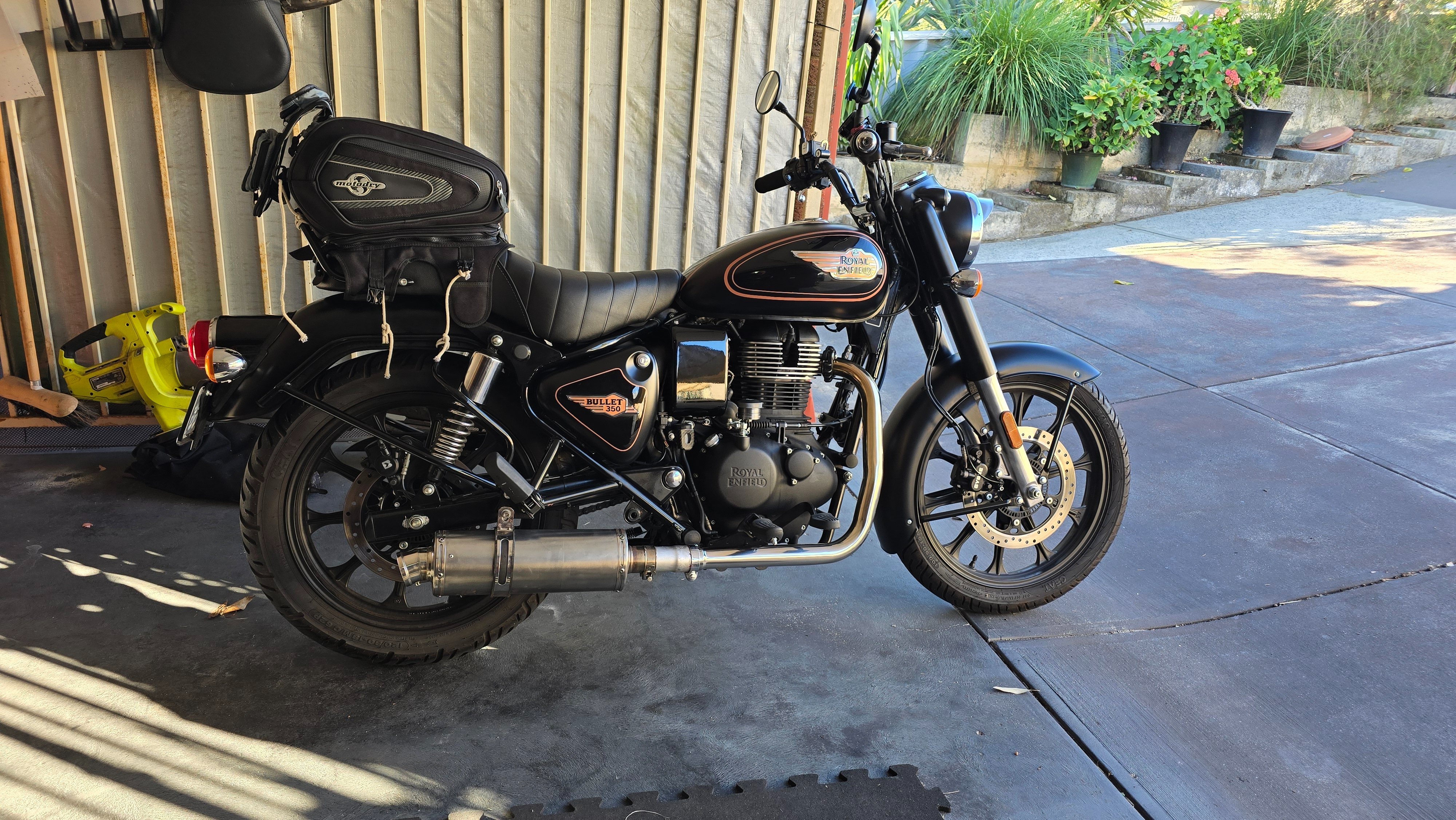

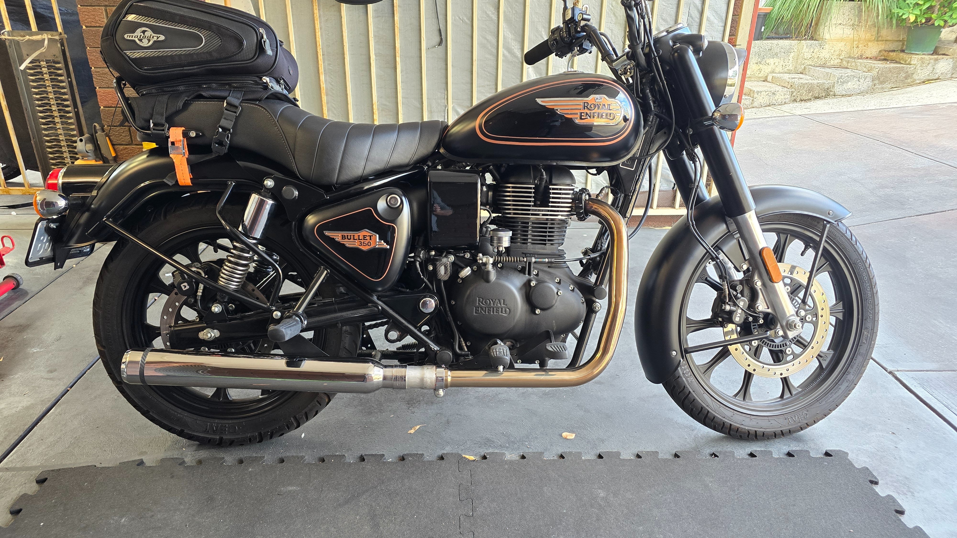

Fitted a new Header pipe to my old Lextek muffler, a short joiner has the broad band O2 sensor for my AFR Meter and will at some stage be removed so perhaps a different muffler at some stage.
This header is part of a Meteor complete system, I may have been better off with a the Hitchcock's pipe but freight etc would make that pricey
This header cost 200 of my bucks delivered.
Sounds good and goes good.
