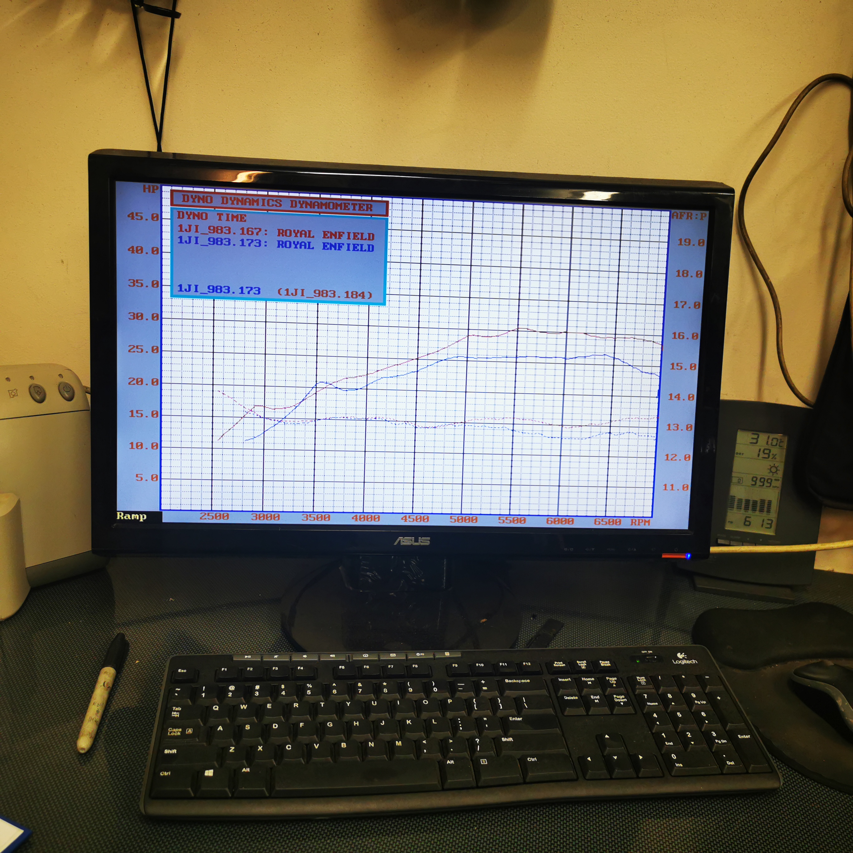

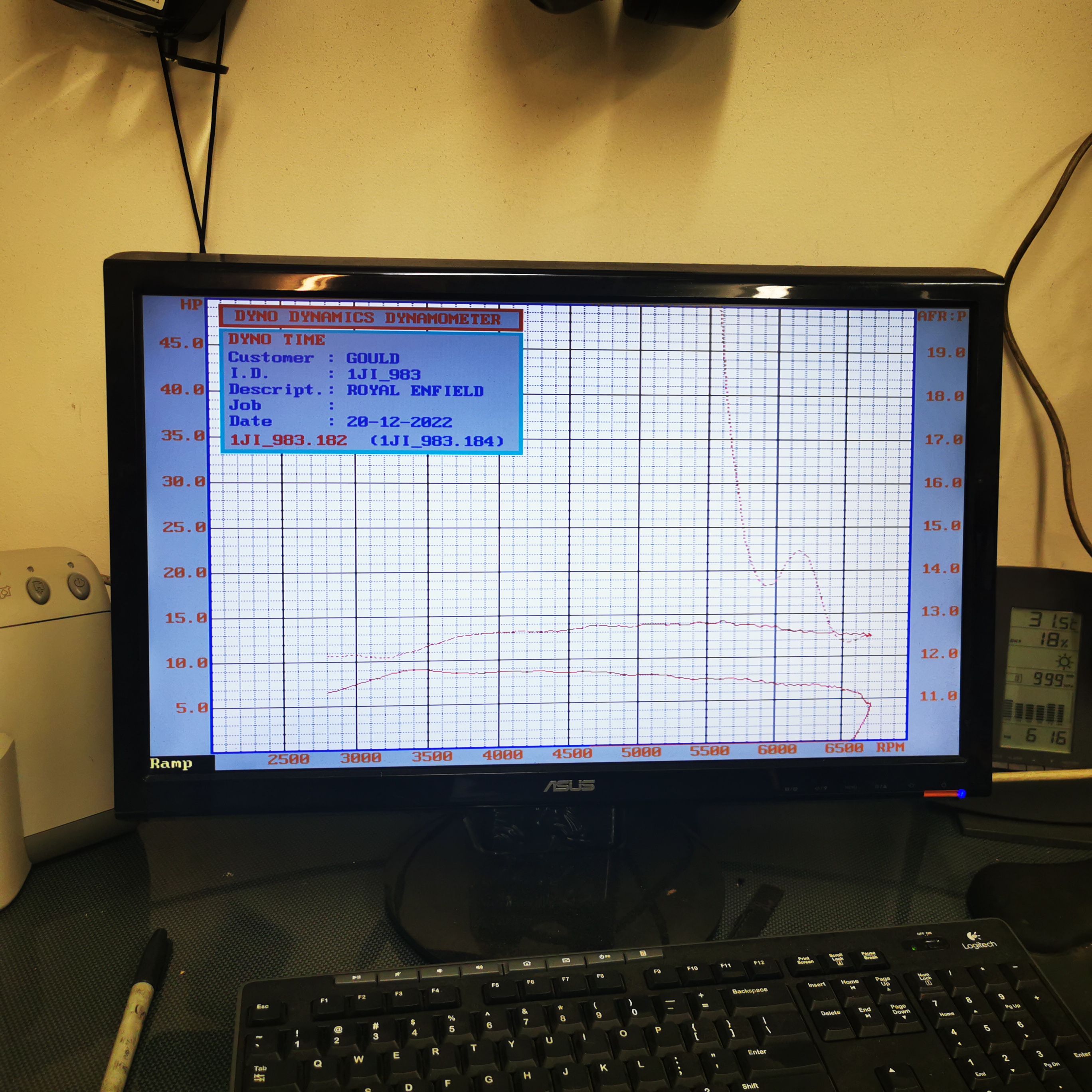

Chart shows the previous run with stock Head and H-T b Cam in Red, Blue is the Loser!
Secxond chart shows how well the Fueling is at 30% throttle, how good is that? Magic !

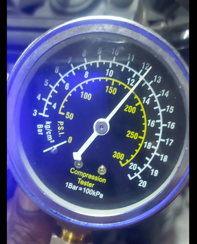

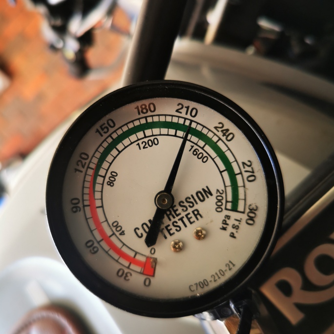

Today. I removed the Stock Cam and replaced it with H-T b Cam, I did compression tests before and after and got results that were the opposite of what I imagined.
190 first up Then after the H-T b Cam went in 220psi :confused:

I only got 180 psi out of my 411 with ht-b cam :unsure:

The duration of Valve openings cause loss of compression, I was told.

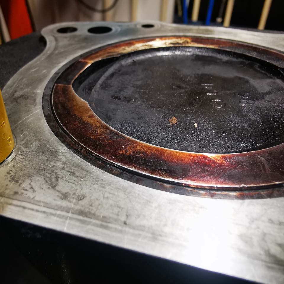

500 comes along, fitted the piston to the Cylinder 3 times just to be sure, first time I didnt like the feel of it so wanted to check the oil ring( good thing I did as the spacer had jumped itself), then after fitting to the Con Rod I realized it was backwards!
I am sure its in right now,
Pics,
1 Italian Pistons are too High! 3rd one Ive had.

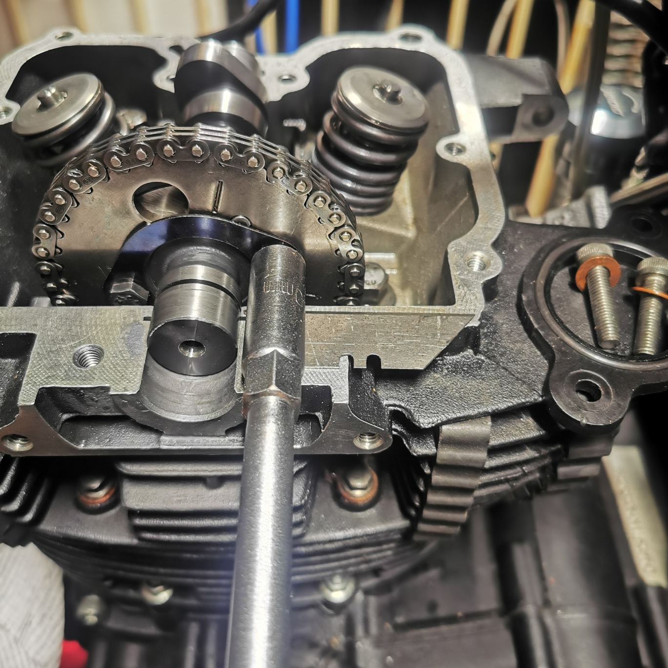

5 The Right way to tighten Cam Bolts, Stanley Blade is not optional.

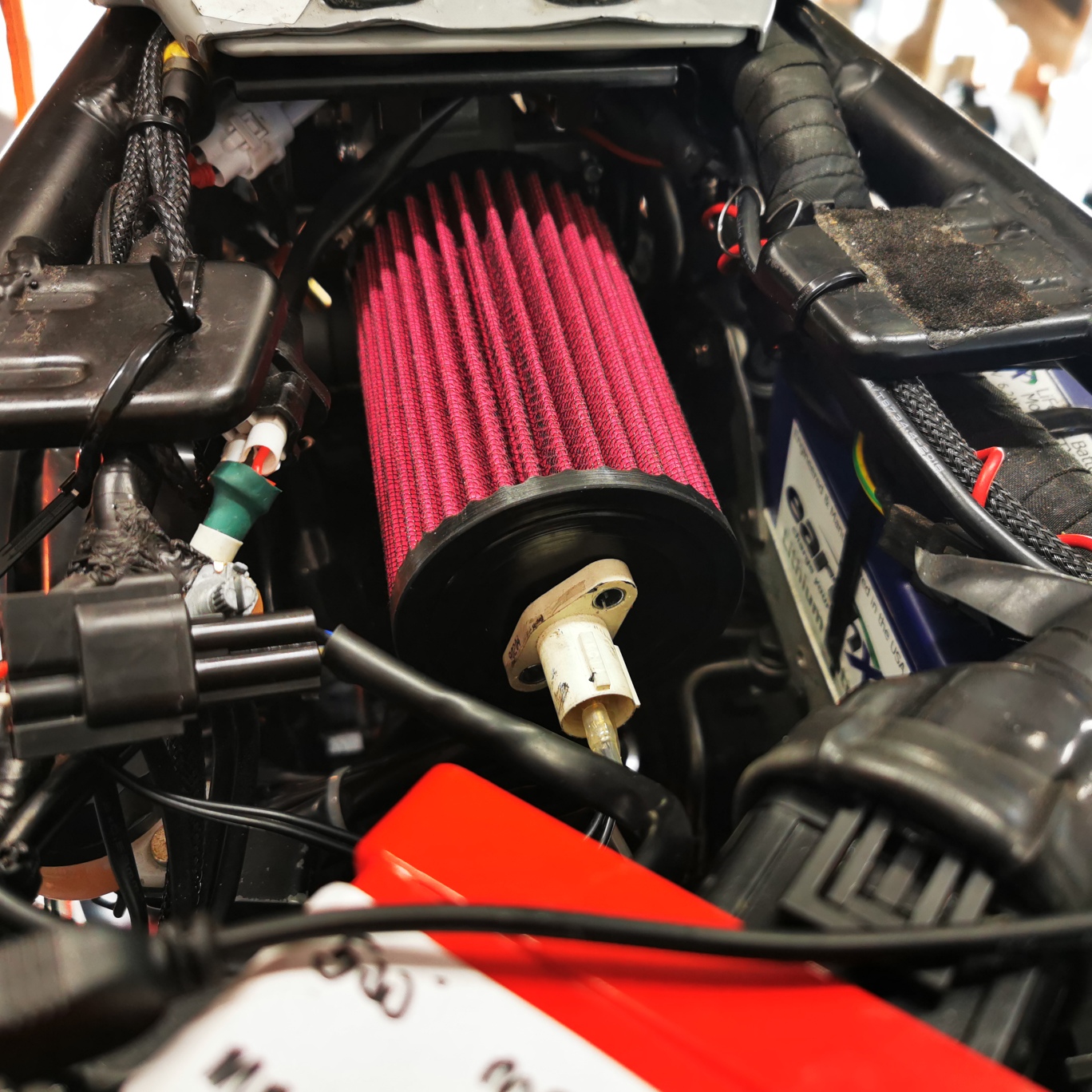

Using a smaller Airfilter and with the IAT sensor "inserted" at the back.

Strange also the Compression has Dropped by nearly ,30 Psi:unsure:
So same build had almost 240psi before the Throttle Body and Cam were changed and the Weather hasnt changed that much:ROFLMAO:
