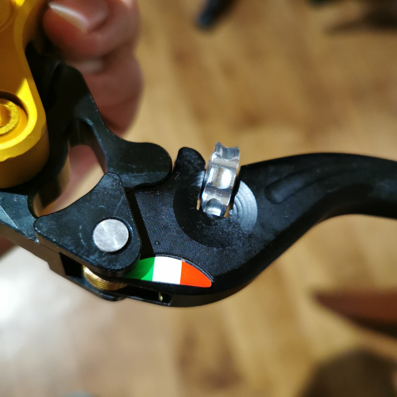

This set up requires very little movement also, I has taken a bit to get used to, handy that the Lever is adjustable.

With this Set up ,12.5 to 14mm, I have to pull the Lever half as much as the Cable.
Seriously with this adjustable lever IMG_20230316_221221_resized_20230316_101420962.jpg the range of movement at the Handle Bars has reduced so significantly that I wonder if it has helped with the, 7 seconds 0 to 100kph, I just recorded. :ROFLMAO:( subject to Verification )
So I will treat H1 to the 19mm Master with the 19mm Slave in an attempt to get more feel🙃 from the 8 plate clutch which is still not Neutral Friendly:censored: but has not Slipped either!
